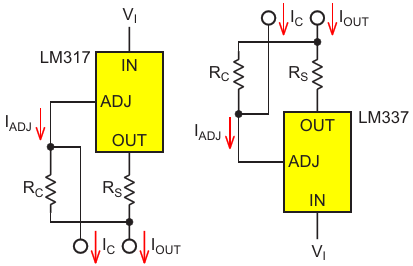

How to control amps …
How to control amps of I
OUT
with mA of I
C
using legacy voltage regulators as current regulators where I
OUT
= (V
ADJ
- I
C
R
C
)/R
S

Cross connect complementary current sources to reduce self-heating error
Figure 1. How to control amps of I
OUT
with mA of I
C
OUT
= (V
ADJ
- I
C
R
C
)/R
S
Figure 2. LM317 reference variation with junction temperature as seen in page 5 of LM317 datasheet
Figure 3. Cross connection reduces self-heating error because shunt regulator U2 carries most of the current, getting relatively hot, while U1, whose V
REF
is in control, stays relatively cool and accurate
Figure 4. If the 317 and 337 swap places and the diodes reverse, Figure 3's circuit can work for negative current, too
Figure 5. Boost current handling capacity with beefier diodes and more U2s
Figure 6. Negative current source circuit incorporates means for compensating component tolerances, including those of U1 and Z1 references. Note R
S
= 1.1 Ω and should be rated for more than 1 W
