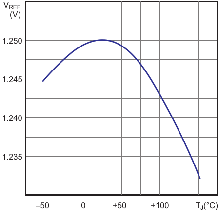

LM317 reference variation with …
LM317 reference variation with junction temperature as seen in page 5 of LM317 datasheet

Figure 2. LM317 reference variation with junction temperature as seen in page 5 of LM317 datasheet
