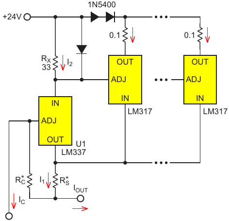

Figure 5. Boost current handling capacity with beefier diodes and more U2s
