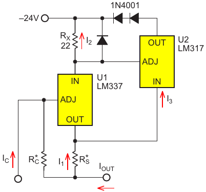

If the 317 and …
If the 317 and 337 swap places and the diodes reverse, Figure 3's circuit can work for negative current, too

Figure 3. Cross connection reduces self-heating error because shunt regulator U2 carries most of the current, getting relatively hot, while U1, whose V
REF
is in control, stays relatively cool and accurate
Figure 4. If the 317 and 337 swap places and the diodes reverse, Figure 3's circuit can work for negative current, too
