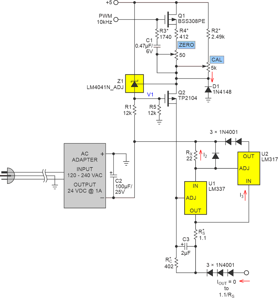

Figure 6 integrates this idea into a complete PWM controlled negative current source as detailed in: “A negative current source with PWM input and LM337 output” (Ref. 1)
Negative current source circuit incorporates means for compensating component tolerances, including those of U1 and Z1 references. Note RS = 1.1 Ω and should be rated for more than 1 W.
Figure 6. Negative current source circuit incorporates means for compensating component tolerances, including those of U1 and Z1 references.
The one-pass adjustment sequence is:
  1. Set D = 100%
  2. Adjust CAL pot for 1 amp output current
  3. Set D = 0%
  4. Adjust ZERO pot for zero output current.
Done. IOUT = 1.1·D/RS, where D = PWM duty factor.
