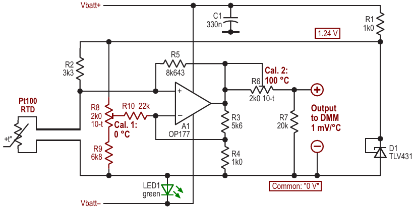

Adding a biasing network …
Adding a biasing network to A1 allows its output to be at 0 mV (common) when sensing 0 °C, and to swing negative for lower temperatures

Figure 1. Using a precision op-amp lets us set the output reference level with a passive network because thermal drifts and mismatches are no longer a problem. LED1 acts both as a rail-splitter and a power indicator, while LED2 gives a simple low-battery warning. T
Figure 2. Adding a biasing network to A1 allows its output to be at 0 mV (common) when sensing 0 °C, and to swing negative for lower temperatures
Figure 3. Plotting the errors for various values of R5 - the positive feedback resistor - shows that we can optimize performance for minimal errors around 0-100 °C (magenta) or accept a wider error band over a greater temperature range. The red curve is within
Figure 4. Changing three components gives an output of 1 mV/°Fahrenheit
Figure 5. A small negative offset allows the basic circuit to give an output directly proportional to absolute temperature
Figure 6. Stripping out all the frills and fancies leaves a basic circuit that is ideal for running off split rails and compatible with most ADCs
Figure 7. Referring the output from the amplifying stage to either a positive reference or to common allows the indication to be switched between Celsius and Kelvin
