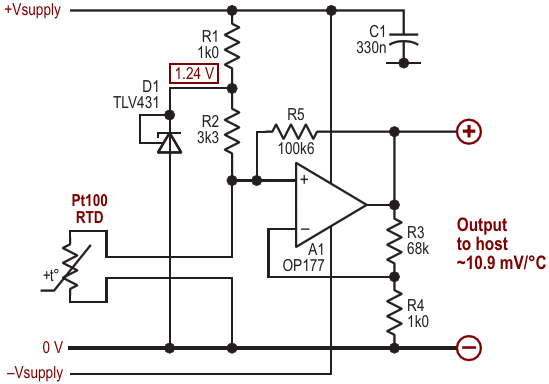

Stripping out all the frills and fancies leaves a basic circuit that is ideal for running off split rails and compatible with most ADCs

Figure 6. Stripping out all the frills and fancies leaves a basic circuit that is ideal for running off split rails and compatible with most ADCs
