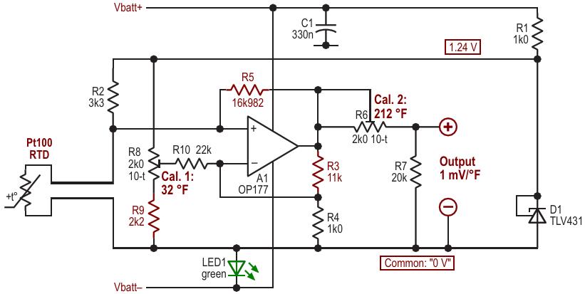

Figure 1. Using a precision op-amp lets us set the output reference level with a passive network because thermal drifts and mismatches are no longer a problem. LED1 acts both as a rail-splitter and a power indicator, while LED2 gives a simple low-battery warning. T
Figure 2. Adding a biasing network to A1 allows its output to be at 0 mV (common) when sensing 0 °C, and to swing negative for lower temperatures
Figure 3. Plotting the errors for various values of R5 - the positive feedback resistor - shows that we can optimize performance for minimal errors around 0-100 °C (magenta) or accept a wider error band over a greater temperature range. The red curve is within
Figure 4. Changing three components gives an output of 1 mV/°Fahrenheit
