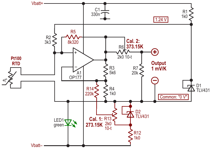

A small negative offset …
A small negative offset allows the basic circuit to give an output directly proportional to absolute temperature

Figure 5. A small negative offset allows the basic circuit to give an output directly proportional to absolute temperature
