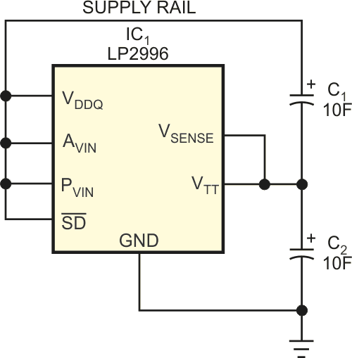

This simple circuit requires only a single IC to balance the charges on two series-connected, low-voltage, high-value capacitors and maintain their common junction at one-half of the supply voltage.
Figure 1. This simple circuit requires only a single IC to balance the charges on
To overcome this undesirable mismatch, the LP2996 DDR termination regulator, IC1, sinks or sources current from both capacitors and actively maintains their voltages at one-half of the supply voltage (Figure 1). The LP2996 provides an active termination for DDR-SDRAM devices and can sink or source large amounts of current; its data sheet's nomenclature and labels reflect its intended memory-support role. The LP2996's Class B output, VTT, drives the capacitors' common connection, actively maintaining the junction at VDDQ/2 and becoming active only when the capacitors get out of balance. At balance, the LP2996 wastes no charging current and thus operates efficiently. The device's data sheet specifies that the LP2996's out-of-balance error amounts to a VTT offset of ±30 mV around the VDDQ/2 setpoint. Figure 2 shows charge and discharge waveforms for 1 A current steps.
