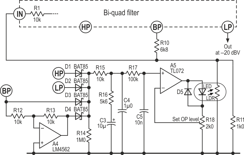

Let’s return to the photoconductive opto-isolator which we used to stabilize the Wien bridge circuit in Part 1. The LDR or photo-resistor part of it is of course linear, but the LED needs careful driving to prevent any significant feed-through of ripple which would modulate the feedback and thus add distortion. Figure 1, showing the control loop added to the basic bi-quad module, incorporates a neat way of minimizing ripple while keeping reasonable loop dynamics. (That module is shown in full in Figure 4 of Part 1.)
Using a decent control loop for the feedback stabilizes the oscillation level without adding significant distortion.
Figure 1. Using a decent control loop for the feedback stabilizes the oscillation level without adding significant distortion.
Because the bi-quad has two outputs (HP and LP) which are in anti-phase, we can easily get full-wave rectification, but we can do much better. The BP output is at 90°/270° to those, so we can also use both that and its inverse to get 4-phase rectification, cutting the ripple to a quarter of the single-phase value. That ripple will also be at four times the fundamental frequency, so we are (roughly) sixteen times better off than we were with the Wien bridge.
With accurately-matched time constants in the bi-quad, all three outputs have identical signal levels at resonance, but any offsets or mismatches will introduce ripple as sub-harmonics of the 4× component (if that makes sense). The diodes must be well-matched, and the op-amps need to have low voltage offsets, or at least lower than any diode mismatches. Good tracking between the tuning pot sections is needed; often an extra resistor paralleled with the higher-value half gives adequate results.Good tracking between the tuning pot sections is needed; often an extra resistor paralleled with the higher-value half, equalising the sections, gives adequate results.
R16, C3, and C4 form the loop filter needed for stable operation, while R17 and C5 give extra filtering of the 4× component. These values are compromises; the loop is somewhat underdamped but gives decent performance over the entire tuning range and takes less than 500 ms to stabilize. A5 translates the filtered voltage into a current to drive the LED, thus controlling the LDR’s resistance. The opto-isolator used was a Silonex NSL-32SR3; a home-brew device made from a (recycled) NSL-19M51, a clear white T-1 LED, and thick black heatshrink worked well; though with about half the sensitivity. (I used that when experimenting with squashed tri-waves (Ref. 2), even though it wasn’t needed in the final cut.) R18 – the only adjustment needed – sets the LED drive, and thus the AF output level.
The feedback loop is closed through the network of R10, R11, and the LDR. At startup, the LDR has a high resistance, but there is enough feedback to start oscillation, after which it progressively shorts R11 to give the desired signal level.
LDRs are fairly sluggish in their response times. This one has a resistance of about 1.7k at our drive level, responding to light in ~6 ms and to dark in ~30 ms (measured 63% figures). This gives us some useful extra ripple filtering, while also affecting the control loop dynamics.

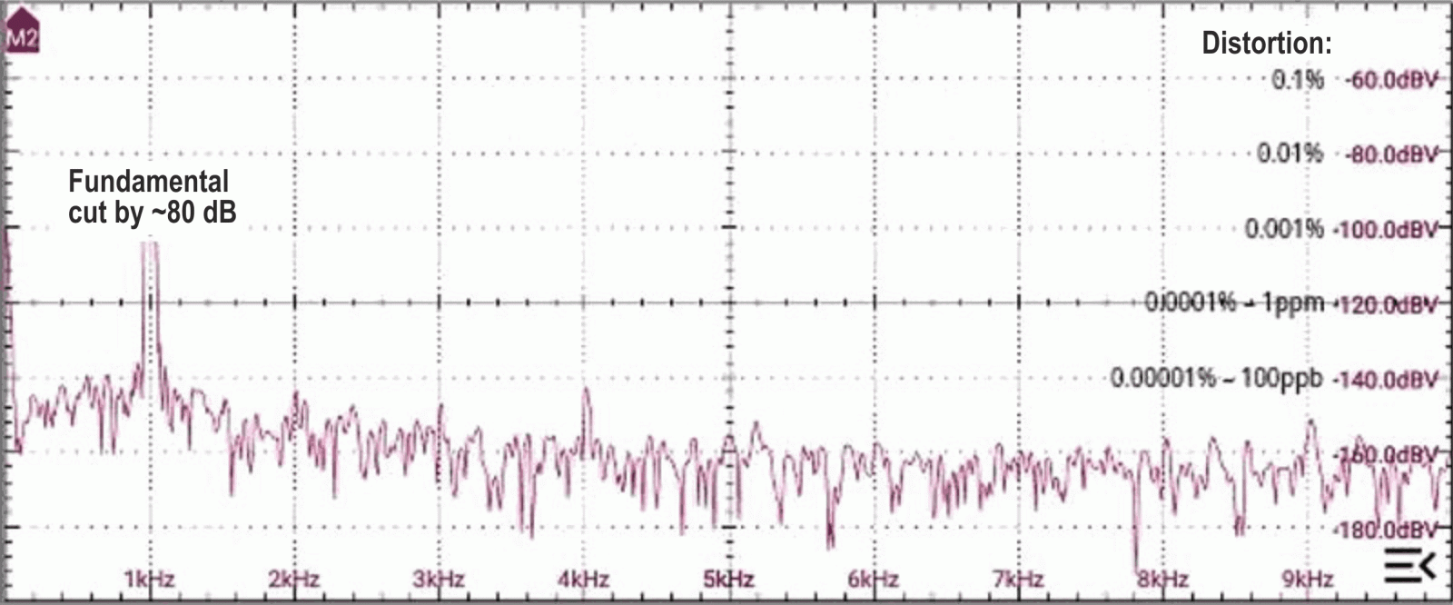

I chose to use a working level of 20 dBV as being a good compromise between distortion and usability. My final unit has extra output gain, given by a virtual-earth/pseudo-log-pot stage (LM4562, of course). Figure 4 shows the notched spectrum from that, measured at +6 dBu (~+4 dBV, or ~1.54 V RMS, or ~4.4 V pk-pk), showing a THD of close to –120 dB, or 1 ppm, most of that being second harmonic (source as yet unidentified).
Spectrum (notched) after amplification to +6 dBu. Note the altered scale.
Figure 4. Spectrum (notched) after amplification to +6 dBu. Note the altered scale.
I think we’re there, as far as distortion goes.

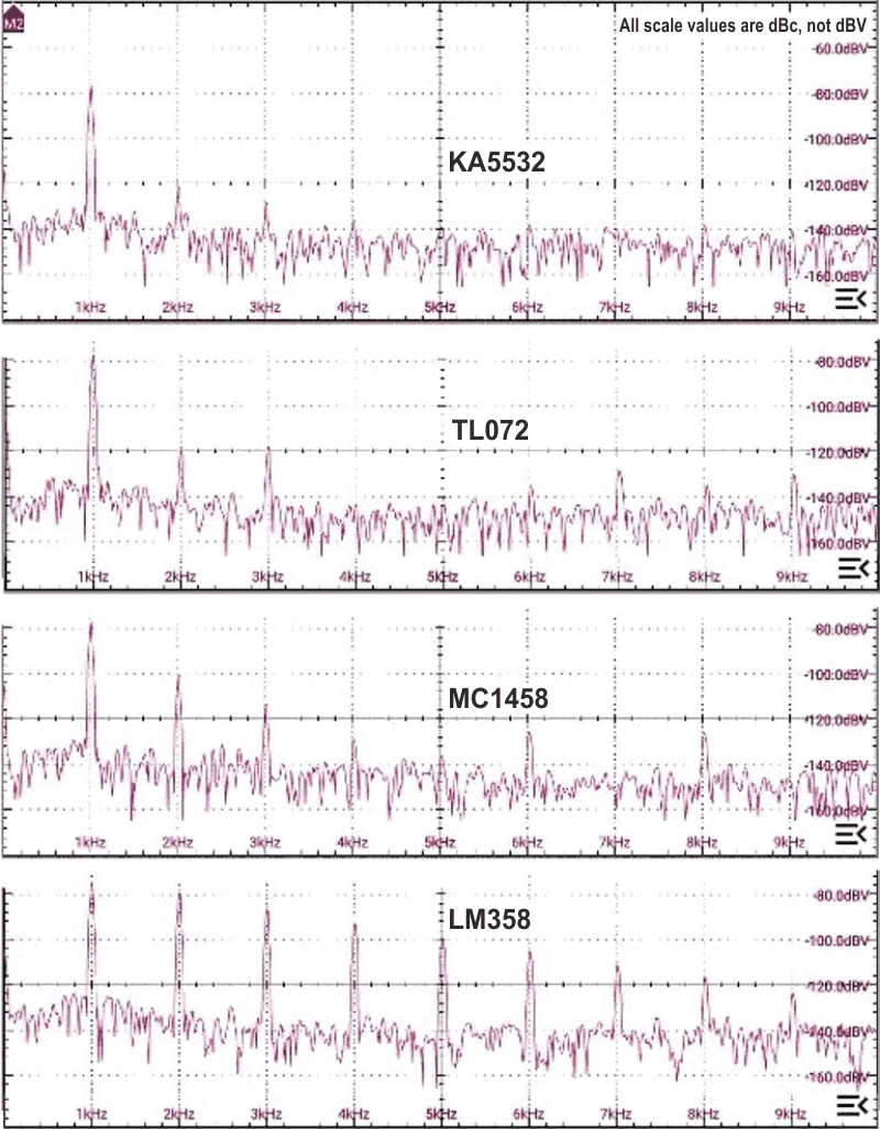

Because I used sockets for A1‒A4, this being a re-build of a defunct unit, trying some other op-amps was easy. Figure 5 shows the results for the KA5532, formerly well-regarded for audio work, TL072/TL082 (or TL0n4 quad-packs), LM358 (with extra 10k resistors to Vs- tacked onto the outputs), and even the venerable MC1458 – essentially twin 741s. Frequency and output level were trimmed for each run to allow proper comparisons. The LM358 surprised me; had to double-check it. Never did like the sound of them, and now I know why.
