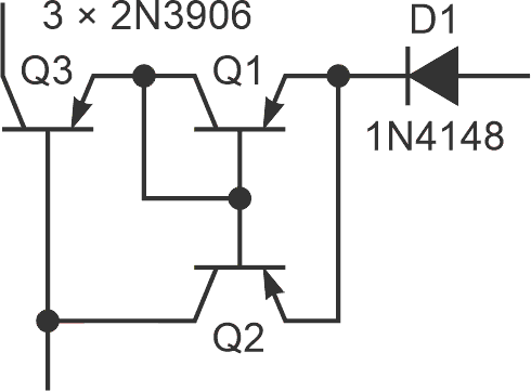

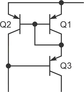

One of the more important factors of these is the “Early effect”, that kicks in to cause significant current imbalance when the voltage drop across the mirror becomes more than a couple of volts. Happily, a fix for the Early effect was devised back in 1967 by George R. Wilson, an IC design engineer at Tektronix. Wilson’s simple yet ingenious fix consisted of adding a third transistor to the basic current mirror, Q3 in Figure 1.
The Wilson mirror improves accuracy despite Early-effect by adding Q3.
Figure 1. The Wilson mirror improves accuracy despite
Due to Q3, the difference in voltage drop across the active mirror transistors Q1 and Q2 never differs by more than one VBE, which reduces Early effect error to less than 1%. Figure 2 shows a variation of the basic two-sided current mirror incorporating Wilson’s accuracy-enhancing extra transistor.
A two-way current mirror with Wilson enhancement.
Figure 2. A two-way current mirror with Wilson enhancement.

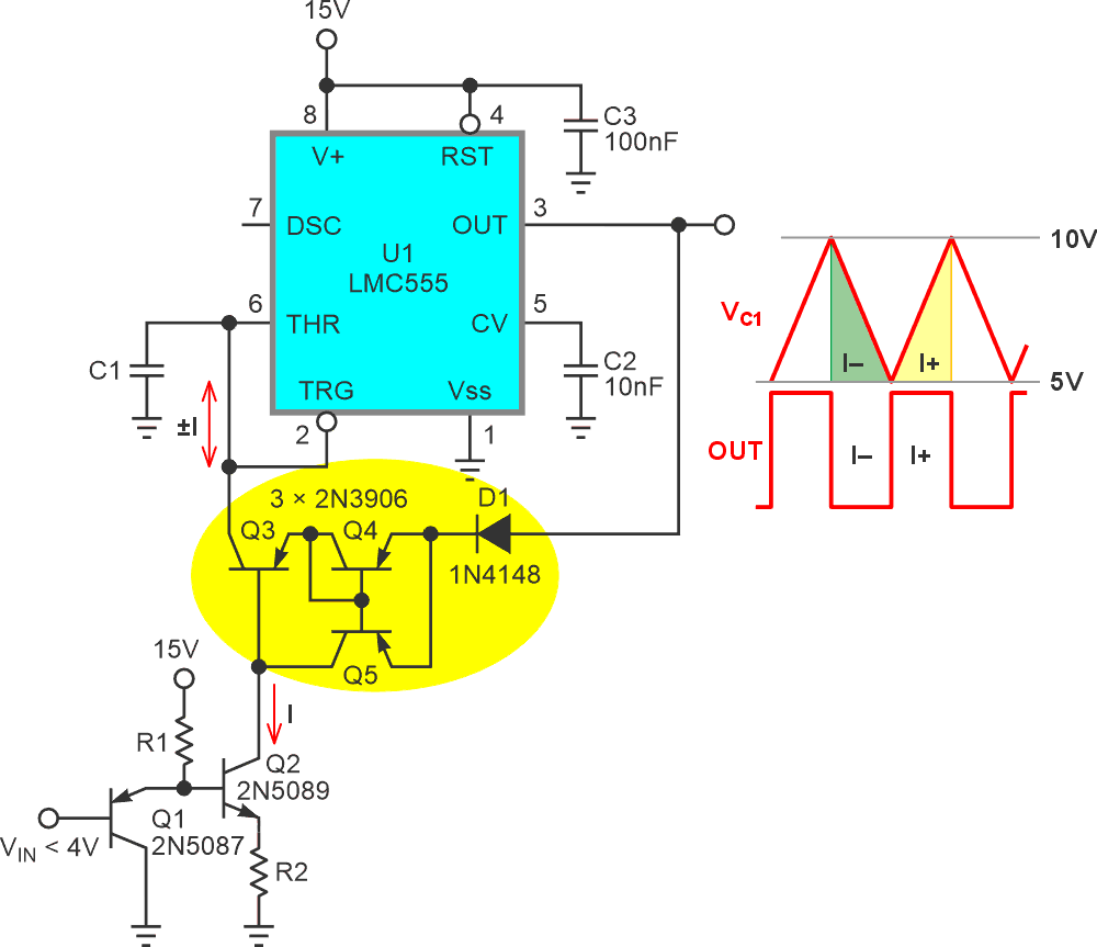

This advantage is exploited in the Figure 3 triangle-wave oscillator to achieve good T-wave symmetry despite as much as 10v being applied across the mirror.
D1, Q3, Q4, and Q5 comprise the two-way Wilson current mirror. It passively conducts Q2's collector current to C1 via Q3's base-collector when OUT versus
Figure 3. D1, Q3, Q4, and Q5 comprise the two-way Wilson current mirror. It passively conducts Q2’s collector current to C1
via Q3’s base-collector when OUT versus VC1 is negative, but becomes an active inverting unity-gain current source
when OUT goes positive and reverses the polarity. Keep variable VIN < 4v so Q2 won’t saturate on negative output peaks.
The Wilson mirror is the better choice for Figure 3, but it isn’t always the superior option. That’s because the extra transistor adds an extra VBE to the minimum voltage drop when the mirror is active. This is no problem for Figure 3 because of its operation from 15v, but would be a deal breaker in the previous DI (Ref. 1) with its 5v-powered oscillator. Luckily, for the same reason, Early already wasn’t much of an issue there.
