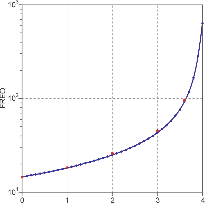

Figure 2 shows a QSPICE simulation of frequency with respect to CV from 0 V to 3.9 V in 100 mV steps.
Figure 2. QSPICE simulation of frequency with respect to
A prototype with component values from Figure 1 and V+ = 12 V has been breadboarded, and a rough frequency-versus-CV curve is measured and marked with a red dot in the QSPICE simulation in Figure 2.
