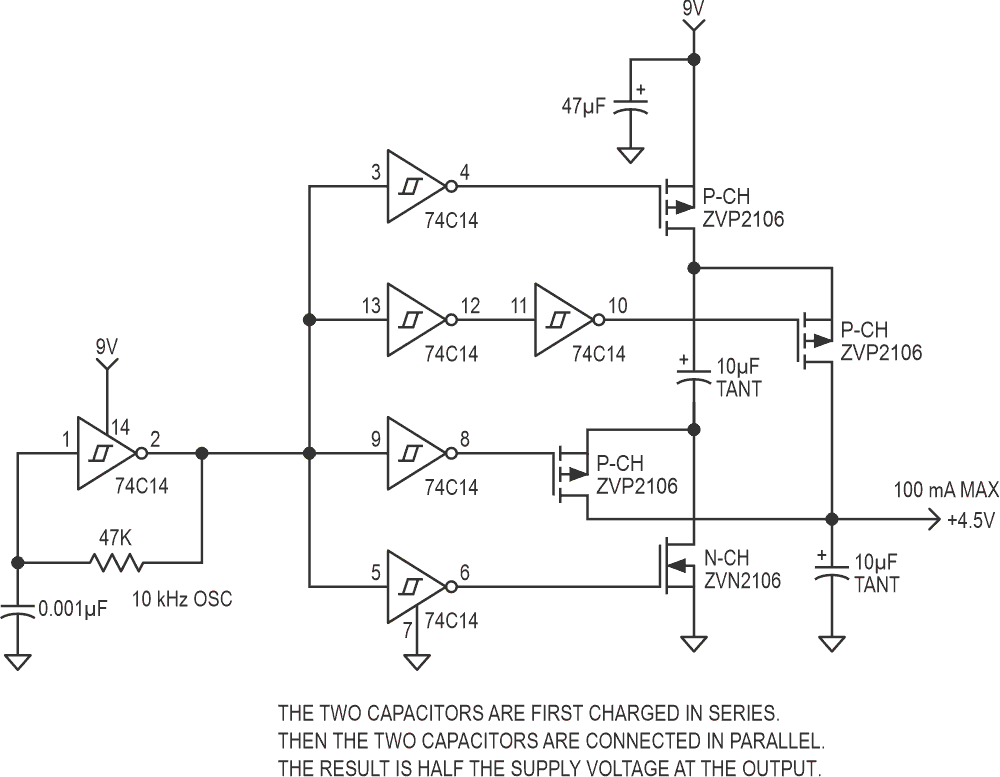

Charge pump efficiently divides supply voltage
Jun 17, 2026
Fairchild MM74C14
David A. Johnson
This circuit uses a few FETs and logic devices to down convert a DC voltage to about one half its value.
