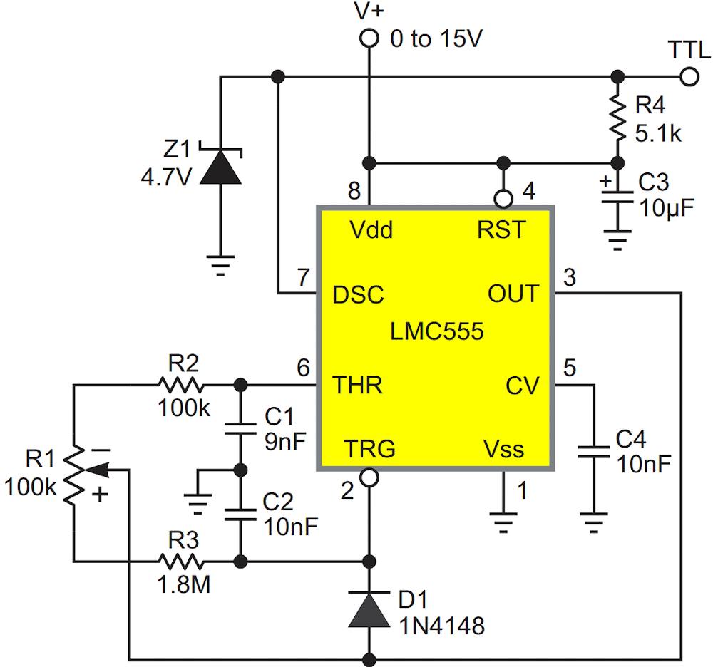

This circuit enables you to generate remote control PWM test signals with a (very) generic (and cheap) chip.

So I decided to work toward a Design Idea that would be more familiar (and friendly?), not needful of (too many) extra external components, (mainly) more accurate, and hopefully a bit cheaper. Figure 1 shows what my labors achieved.
This Design Idea leverages a LMC555 as a variable duty cycle (1 ms to 2 ms = 5% to 10%), constant frequency (20 ms = 50 Hz) PWM oscillator. Timing is ratiometric and therefore independent of V+ so no external voltage regulator is needed.
Figure 1  This Design Idea leverages a LMC555 as a variable duty cycle (1 ms to 2 ms = 5% to 10%),

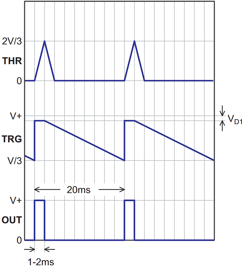

How it works is (roughly) sketched in Figure 2’s timing diagrams.
The PWM oscillation cycle alternates between the Threshold pin for the duration of the 1 ms to 2 ms ON halfcycle is adjusted by R1, and the Trigger pin for the 18 ms to 19 ms OFF halfcycle. C2 > C1 to compensate for D1 forward drop.
Figure 2  The PWM oscillation cycle alternates between the Threshold pin for the duration of the

independently of R1 setting.
D1 recharges C2 during the PWM on interval. Z1 limits the output amplitude to TTL-safe levels. And given that LMC555s can be had for about a dollar in singles, I’d say the hoped-for price point box was also checked.
