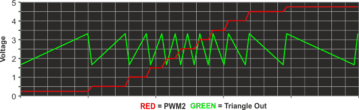

A useful capability for a triangle generator is programmable production of both symmetric and asymmetric (sawtooth) waveforms. In this design, waveshape is controlled by VPMW2 as illustrated in Figure 3. Setting VPMW2 to 2.5 V yields a symmetrical triangle waveshape, while settings nearer 0 or 5 V produce sawteeth. A1’s rail-to-rail input will accept VPMW2 settings as close to ground or V+ as needed to generate the desired waveshape.
| Figure 3. | The waveshape versus VPMW2. |
The duty cycle of Pulse Out also follows VPMW2, ranging from near 0% for VPMW2 near 0 V, to 50% for 2.5 V, and approaching 100% for VPMW2 near 5 V.
