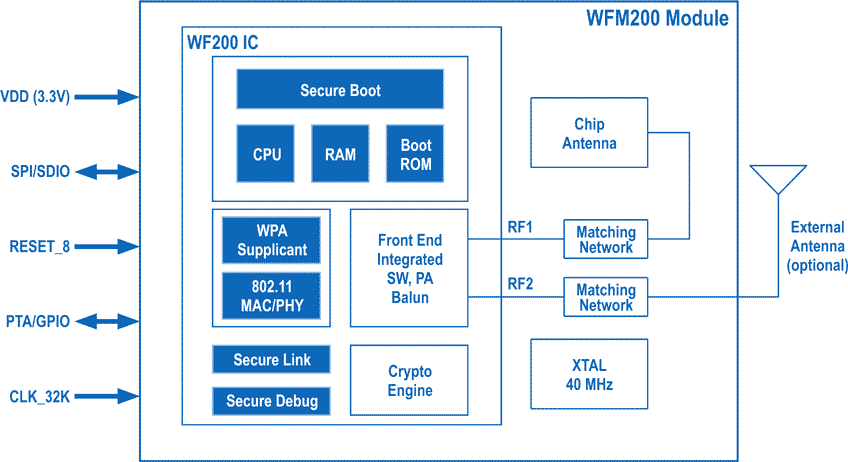

Block Diagram of the WFM200 Module
Block Diagram of the WFM200 Module.

Security comes from secure boot within the SiP to authorise on-board firmware, and debug is also secured to block unauthorized access to debug ports. On-board hardware cryptography acceleration supports AES, PKE and TRNG.
Taking security to a further level, the bus connecting the device to a host MCU is encrypted – so requiring encryption processing in the host – which dramatically cuts the chances of a customer PCB being probed to extract secrets.
