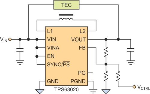

The power-supply in Figure 1 is a circuit that can source and sink current for a low-power TEC. For example, a buck-boost converter such as the TPS63020 is used to either buck or boost the supplied input voltage in order to generate the desired current-flow direction. The topology of a buck-boost converter supports a wide output-voltage range, in this case from 1.2 to 5.5 V.

By integrating all power MOSFETs and requiring a minimum of external components, this circuit is a more preferred approach for low-power TECs where size is critical, such as in the smallest optical-networking modules. The buck-boost converter is powered from the common 3.3-V rail found in optical networking modules. The TEC’s connections to the power supply (Figure 2) allow a +2.1- to –2.2-V voltage difference across the TEC. Furthermore, the commonplace operating point near zero-current is easily supported in this configuration.

Figure 2. This circuit generates a bidirectional current flow through
a TEC with just one converter and a few passive components.
TEC orientation is critical to its heating or cooling. Modern electronics often appear to be somewhat warm and easy to further heat up. However, it’s usually more difficult to cool a TEC enough to achieve the desired laser wavelength. Therefore, it's better to wire the TEC so that it’s cooling when the buck-boost converter is sourcing current. The TPS63020, like many converters that both source and sink, can source more current than it can sink. Therefore, it can deliver a smaller amount of power when sinking, so sinking current should be used to heat the TEC.

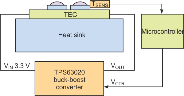

Figure 3. In a complete closed-loop TEC temperature-regulation circuit, the
MCU reads the temperature sensor and generates an output control
signal to the buck-boost converter to adjust the TEC’s
temperature appropriately.
In the complete system (Figure 3), a microcontroller (MCU) monitors a temperature sensor on the TEC. Based on the TEC’s actual-versus-desired temperature (the setpoint), the MCU adjusts the control signal (VCTRL) to move the buck-boost converter to a new operating point, sourcing or sinking more or less current to adjust the temperature.
