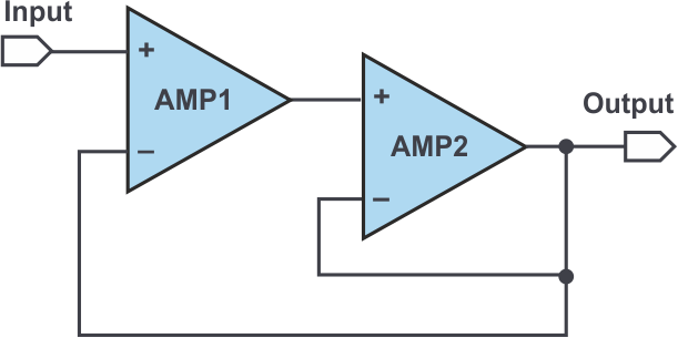

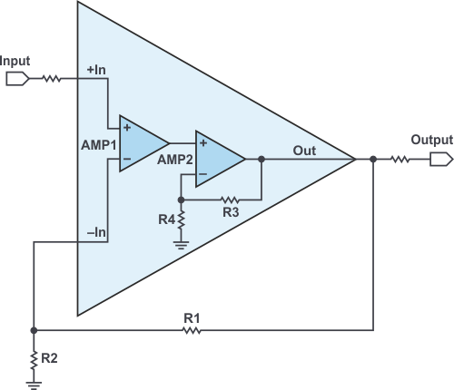

Referring to Figure 1, AMP1 should have excellent dc precision as well as the noise and distortion performance required by the application. AMP2 should provide the output drive requirements. In this arrangement, the amplifier (AMP2) with required output specifications is placed inside the feedback loop of an amplifier (AMP1) with the required input specifications. Some of the techniques and benefits of this arrangement will be discussed.

When initially encountering a composite amplifier, the first question that may arise is how to set the gain. To address this, it is helpful to view the composite amplifier as a single noninverting op amp contained within the large triangle, as in Figure 2. If we imagine the triangle is blacked out so that we couldn’t see what’s inside, then the gain of the noninverting op amp is 1 + R1/R2. Revealing the composite configuration inside the triangle doesn’t change anything – the gain of the whole thing is still controlled by the ratio of R1 and R2.
Composite amplifier seen as a single amplifier.
Figure 2. Composite amplifier seen as a single amplifier.
In this configuration it is tempting to think that changing the gain of AMP2 by means of R3 and R4 will affect the output level of AMP2, indicating a change in composite gain, but this is not the case. Increasing the gain around AMP2 via R3 and R4 will simply decrease the effective gain, and output level, of AMP1 such that the output of the composite (AMP2 output) remains unchanged. Alternatively, decreasing the gain around AMP2 will serve to increase the effective gain of AMP1. So, in general, the gain of the composite amplifier is only dependent on R1 and R2.

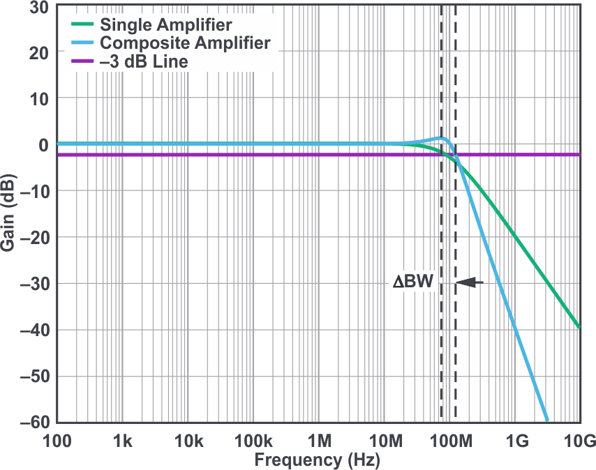

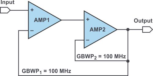

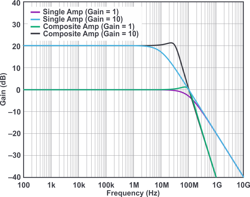

Referring to Figure 3 and Figure 4, let’s say we have two separate amplifiers each having a gain-bandwidth product (GBWP) of 100 MHz. Putting them together in a composite configuration will increase the effective GBWP of the combination. At unity gain, the composite amplifier offers a ~27% higher –3 dB bandwidth, albeit with a small amount of peaking. However, at higher gains this benefit becomes much more noticeable.
-3 dB BW improvement at unity gain.
Figure 4. –3 dB BW improvement at unity gain.

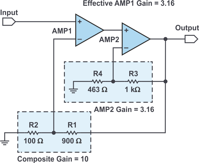

Figure 5 shows the composite amplifier in a gain of 10. Note the composite gain is set to 10 via R1 and R2. The gain around AMP2 is set to approximately 3.16, forcing the effective gain of AMP1 to be the same. Splitting the gain equally between the two amplifiers yields the greatest possible bandwidth.

Figure 6 shows the frequency response for a single amplifier at a gain of 10 compared to a composite amplifier configured with the same gain. In this case, the composite offers a ~300% increase in –3 dB bandwidth. How is this possible?
-3 dB BW improvement for gain = 10.
Figure 6. –3 dB BW improvement for gain = 10.

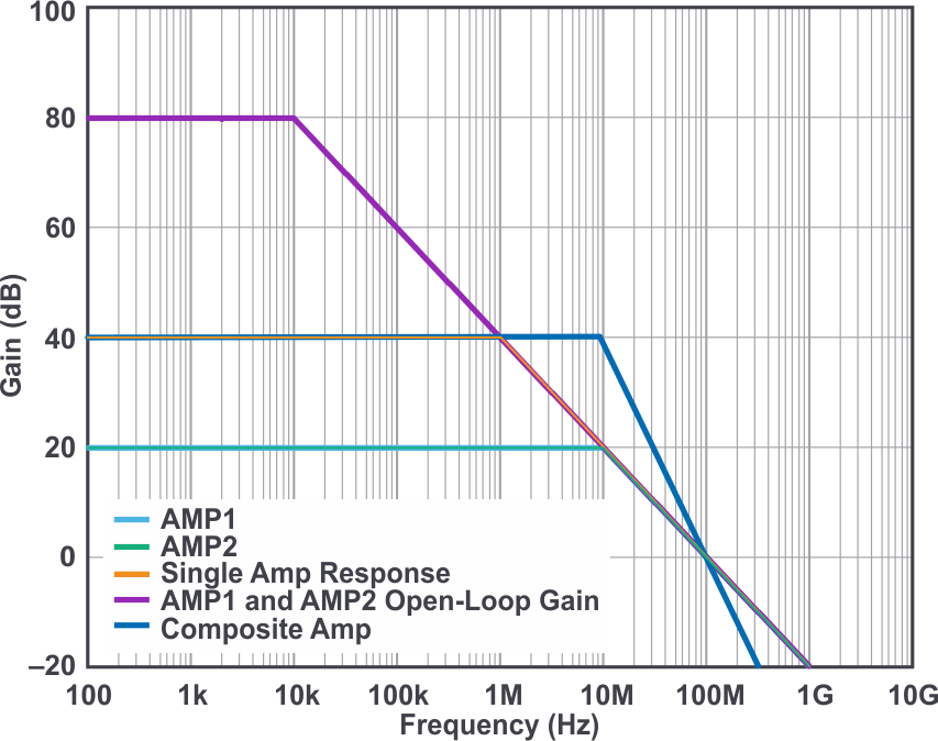

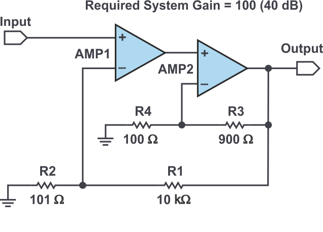

For a specific example, refer to Figure 7 and Figure 8. We require a system gain of 40 dB and will use two identical amplifiers, each with an open-loop gain of 80 dB and a GBWP of 100 MHz.
Gain splitting for maximum bandwidth.
Figure 7. Gain splitting for maximum bandwidth.
To realize the highest possible bandwidth for the combination, we will split the required system gain equally between the two amplifiers, giving each of them a gain of 20 dB. So, setting the closed-loop gain of AMP2 to 20 dB forces the effective closed-loop gain of AMP1 to 20 dB as well. With this gain configuration, both amplifiers operate lower on the open-loop curve than either of them would at a gain of 40 dB. As a result, the composite will have higher bandwidth at the gain of 40 dB as compared to the single amplifier solution of the same gain.
