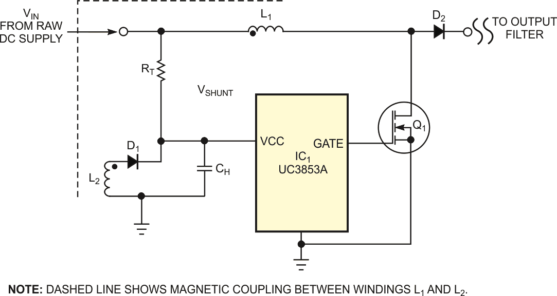

In certain applications, design requirements may call upon a system's switched-mode power supply to more promptly deliver its output than would the garden-variety power supply. Figure 1 shows such a supply's bootstrap, or start-up, circuit. In a switched-mode power supply's PFC (power-factor-corrected) preregulator, the circuit's PWM (pulse-width modulator), IC1, draws its normal operating power from auxiliary winding L1, wound on boost inductor L2’s magnetic core and diode D1.
| Figure 1. | In a conventional switched-mode power supply’s bootstrap circuit, trickle-charge resistor RT and capacitor CH supply start-up power to the pulse-width modulator and controller, IC1. |
Resistor RT and capacitor CH form a trickle-charge circuit that supplies power for bootstrapping into normal operation. In conventional designs, RT comprises a high resistance that delivers just enough current to overcome the standby current and supply a trickle charge to holdup capacitor CH, which stores enough energy to power the PWM circuit until the power converter begins operation. Under normal circumstances, the circuit's slow start-up response poses no problems.
