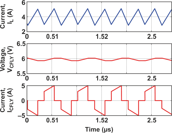

CFLY ripple voltage and current relative to inductor ripple current.
Figure 6. CFLY ripple voltage and current relative to inductor ripple current.
Sizing CFLY for acceptable ripple voltage and current is critical for 3L operation. In fact, keeping CFLY balanced at VIN/2 during transients, startup, at light load and D = 100% is not trivial and requires some additional, proprietary circuitry not shown in Figure 2. Figure 6 shows an example waveform for ∆IFLY relative to normalized ∆IL.
Equations 2 and 3 are for CFLY ripple voltage and current:
  (2)
  (3)
CFLY ripple voltage peaks at D = 0.5 and increases directly with load current. After factoring in ceramic capacitor derating from DC bias and temperature, CFLY must withstand half the input voltage. Note that at D = 0.5, IC(FLY) sees the full load current. CFLY capacitance is sized to keep DVC(FLY) less than 10% of VIN/2 in order to ensure loop stability. To ensure long capacitor life, the capacitor package size and RMS current rating must be large enough to handle the associated temperature rise.

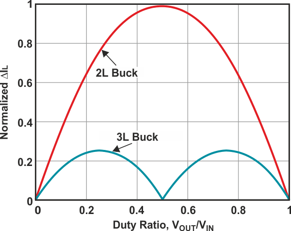

The 180-degree phase-shifted gate drive for Q3 and Q4 effectively doubles the converter’s switching frequency at VSW. Additionally, by keeping CFLY balanced at VIN/2, the three-level converter reduces the volt-seconds across the inductor by half. The combination results in a one-quarter reduction in inductor ripple given the same inductor and fSW. The reduction in inductor ripple current compared to the 2L converter switching at the same frequency over duty cycle is apparent in Figure 7.
Duty cycle comparison of 2L and 3L converters.
Figure 7. Duty cycle comparison of 2L and 3L converters.

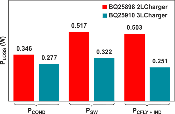

Figure 8 shows the power losses for the BQ25910, modeled using the equations in Table 1 and actual silicon process data. Also shown are the losses for the BQ25898. Note how the inductor DCR losses dominate the total losses for both chargers.
modeled power losses.
Figure 8. modeled power losses.

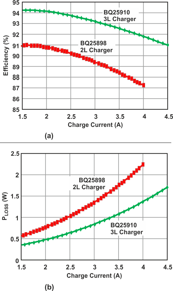

Figure 9a shows a plot of the BQ25910 and BQ25898 measured efficiency at a 9-V input voltage and a 3.8-V battery voltage. Figure 9b compares the losses of the two converters. At a 3-A charge current, the BQ25898 efficiency is 89.3%. From Figure 8, the BQ25910’s PLOSS is 0.850 W from a total output power of 3 A × 3.8 V = 11.4 W, resulting in 93.1% efficiency, which is very close to the measured 93.2%.
BQ25910 and BQ25898 measured efficiency and power losses.
Figure 9. BQ25910 and BQ25898 measured efficiency and power losses.
At a 9-V input voltage, 3.8-V battery voltage and 3-A charge current, the 3L BQ25910 has a 3.9% efficiency improvement and 36% loss reduction. For a loss budget of 1.5 W, the BQ25898 can provide 3.2 A of charge current, while the BQ25910 can provide 4.2 A of charge current (a 31% increase) in a 36% smaller solution size.
