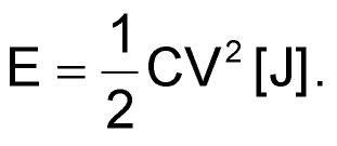

Charges or charged particles are point sources of an electrostatic field (E‑field). Field lines always emanate from the positive charge(s) and terminate on the negative charge(s). The force between charged particles is attractive when the charges on each particle are complementary and repulsive when the charges are identical. The E‑field stores energy; the amount of energy stored is proportional to the total number of lines of flux (or to the total charge). The error current coupled into measurement conductors is directly proportional to the strength of the field. At any given voltage, the capacitance describes the relationship between charge and voltage on two conducting bodies. The energy stored in the field is equal to one-half of the capacitance multiplied by the square of the voltage:

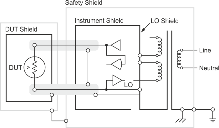

The proper use of the shield in a test system. The electrostatic shield is grounded to circuit common. Notice that both the HI and the LO terminals are shielded
Figure 1. The proper use of the shield in a test system. The electrostatic shield is grounded to circuit common.
The electrostatic shield prevents external E‑fields (a high impedance field) from affecting a measurement circuit by providing an equipotential surface to capture the E‑field, deflecting it from the measurement leads inside. To prevent the shield from coupling internal circuits to one another, the shield ground point is connected to LO inside the instrument. This grounding scheme ensures that internal measurement nodes see only the instrument LO (see Figure 1). To be effective, the shield must cover the entire measurement node. The instrument design should already include this shield wherever it is needed and provide for its extension to the outside world. Although this shield is a good idea for any measurement, it is imperative for high-impedance measurements (i.e., any measurement >100 Kohms). The resulting interference voltage is
where II is the coupled current, and R is the impedance of the measurement. This shield does not prevent DC or AC currents from flowing between the measurement circuits and the shield. The common shield only provides protection from external electrostatic interference.
The driven guard accomplishes all that the common shield does, as well as eliminating the currents from the guard to the measurement circuits (see Figure 2). The guard is simply a common shield buffered or driven to the measurement circuit voltage (instead of connected to instrument LO) to eliminate the E‑field between the guard and the measurement circuit. Guards are used in circuits designed to measure or source very low currents, and are usually mandatory for currents of less than 1 nA.
The proper use of the guard in a test system. Notice that both the HI and the LO terminals are either shielded or guarded, and that the box surrounding the DUT provides a complete electrostatic shield.
Figure 2. The proper use of the guard in a test system. Notice that both the HI and the LO terminals

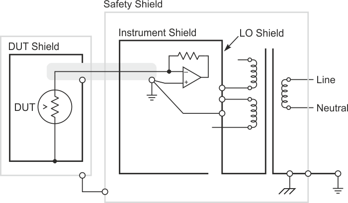

When measuring currents of 1 nA or less, the measurement node must first be guarded. Instruments used to measure or source these levels of current or lower will have the measurement guarded inside. It is not necessary to have a shield in addition to a guard around the measurement node, but the remaining measurement circuitry should be shielded. The electrometer configuration allows a common shield to act as a guard as well, by ensuring that the measurement node is at ground potential (see Figure 3).
An illustration of the shield and guard configuration for an electrometer.
Figure 3. An illustration of the shield and guard configuration for an electrometer.
This suggests that the fundamental difference between a shield and a guard is that a shield prevents external fields from affecting measurements, while a guard adds protection from DC leakage currents by surrounding the measurement node with a voltage identical that of the measurement node, both inside and outside the instrument, eliminating leakage currents.
