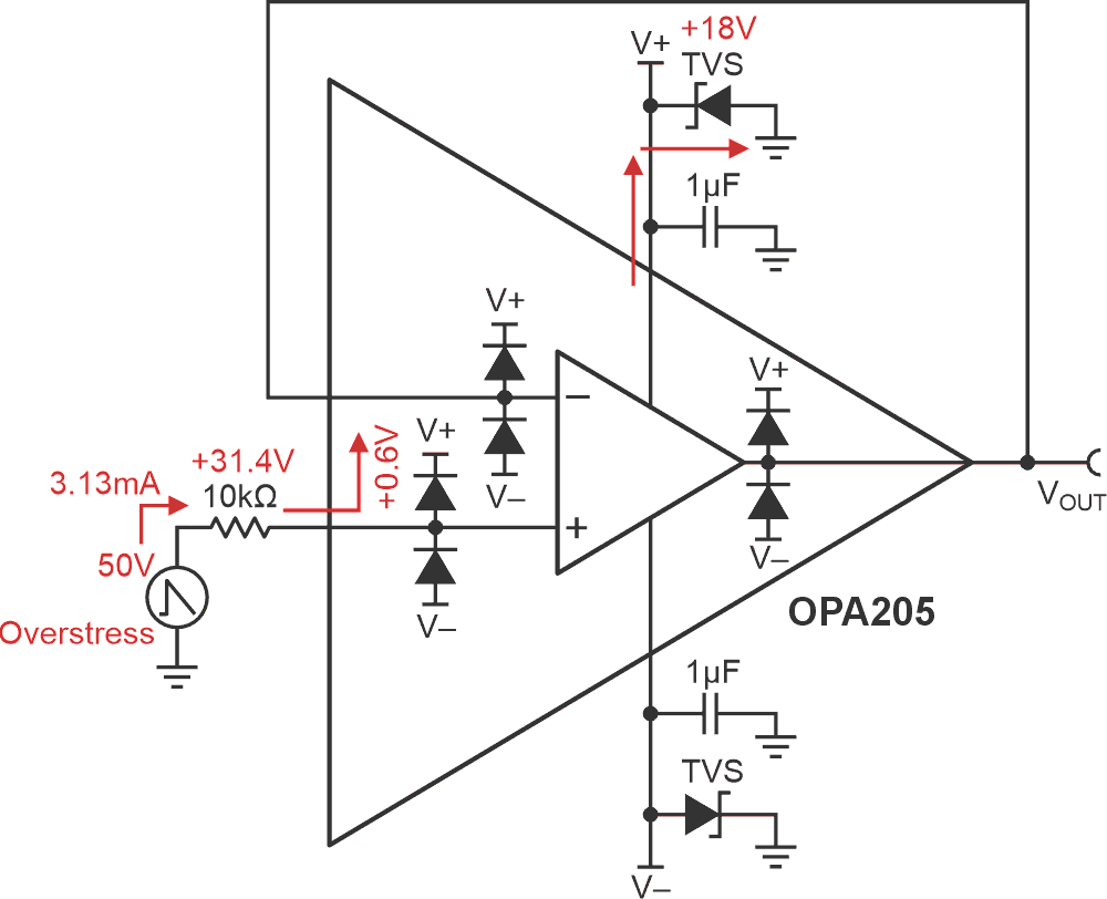

One common approach used to limit op-amp input overstress current is to simply add an input current-limiting resistor and a transient voltage suppressor (TVS) diode on each supply (Figure 2). The resistor will limit the input current, but some of the overstress voltage will still be directed onto the power supply. The TVS diode will protect the power supply from the overstress voltage channeled through the ESD diodes.
| Figure 2. | The electrical overstress (EOS) protection scheme shown uses the OPA205 precision op amp. |
You need a TVS diode because many voltage regulators do not have the ability to sink current, nor can they respond fast enough to protect the supply. The resistance value required to protect the op amp depends on the magnitude of the overstress signal on the input. Large overstress signals will require large resistances.
The example in Figure 2 uses a 10-kΩ resistor to limit the current to a safe level of 3.13 mA for a 50 V overstress signal. Using the protection scheme in Figure 2 can be very effective but does have a few limitations.
The resistor will introduce a DC offset error because of the op-amp input bias current (IB). This error will add directly to the input offset voltage (VOS) of the op amp and limit the circuit’s DC accuracy. Another limitation of the resistive input protection is that resistors generate thermal noise. Equation 1 calculates the noise, enRin, density as:
(1) |
You should then compare this noise to the op-amp noise spectral density specification.
In the example shown in Figure 2, the input noise specification is 7.2 nV/√Hz and the resistor generates 12.8 nV/√Hz. Thus, the overall noise will be dominated by the protection resistor and will be much higher than the noise of the op amp alone.

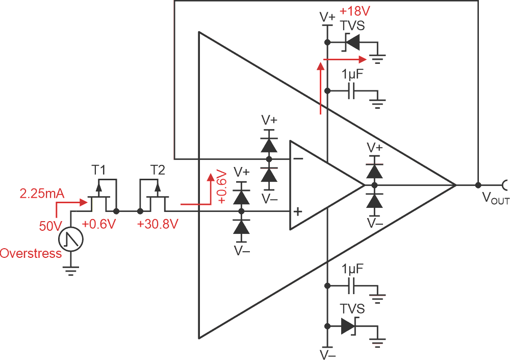

The junction field-effect transistor (JFET) input protection scheme shown in Figure 3 is an approach that enables reliable input protection while minimizing errors from IB and resistor noise. The JFET circuit has low resistance when no current flows through it, but the resistance rapidly increases when current does flow through it.
| Figure 3. | The JFET input protection shows the circuit operation under fault condition. |
Thus, in normal operating conditions, the JFET circuit will have low resistance and add minimal noise and IB error. Under a fault condition, the JFET device will rapidly increase, which will limit current and protect the circuit. When the fault is removed, the JFET will return to its normal low impedance state.
You can build this kind of JFET circuit using discrete JFETs, but it’s also integrated into some amplifiers. In general, when you see the term “input-overvoltage-protected” in amplifier datasheets, the protection is JFET input protection. Using integrated protection will save PCB area, save design effort, and generally reduce overall costs.

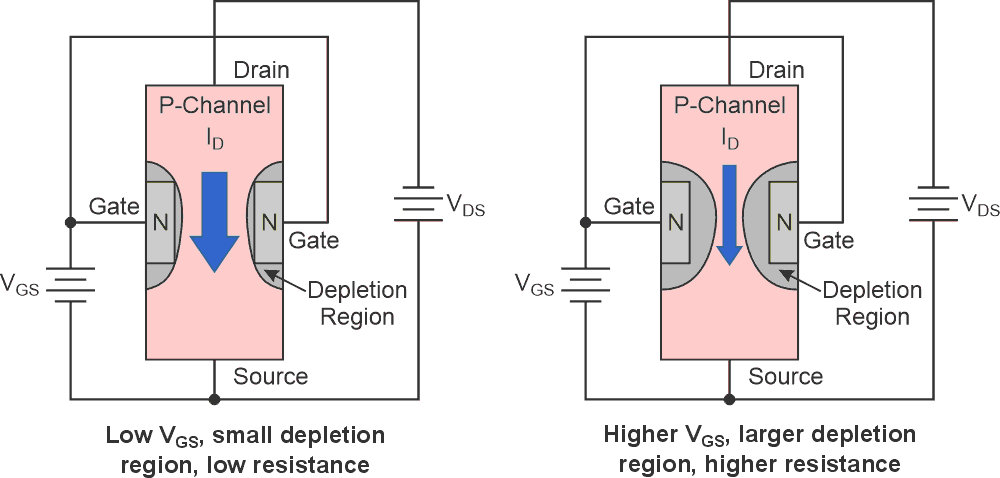

In order to understand JFET protection, let’s review some JFET fundamentals. This article will focus on P-channel JFET devices, but the same approach applies to N-channel devices with the polarities reversed. You can think of the JFET transistor as a voltage-controlled resistance, where the channel resistance is controlled by the voltage gate-to-source (VGS) and the voltage drain-to-source (VDS).
It’s important to understand that the JFET operates in depletion mode. The gate-to-source junction is reverse-biased, which creates a depletion region that restricts channel current flow (ID). Increasing the reverse bias voltage will increase the depletion region, which increases the channel resistance. The lowest resistance happens when VGS = 0 V, which has a very small depletion region, as shown in Figure 4.

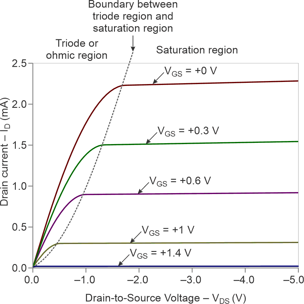

Adjusting VDS will also affect the depletion region. For a lower VDS, the channel acts like a resistor, and the transistor is said to be in its ohmic region or triode region. In the ohmic region, an increase in VDS will cause a proportionate increase in drain current (ID), just as you would see on a resistor (see the left-hand side of Figure 5).
| Figure 5. | See P-channel JFET characteristic curve highlighting ohmic and saturation regions. |
For a higher VDS, the channel pinches off and the transistor is said to be in the saturation region. While in the saturation region, the current through the transistor is held relatively constant for a wide range of drain-to-source voltage (see the right-hand side of Figure 5).
As mentioned earlier, for a JFET, the gate-to-source junction is normally reverse-biased. When forward biased, the JFET will no longer act like a transistor, and the curves in Figure 5 no longer apply. In this case, the JFET will act as a normal PN junction diode with a forward voltage drop of about 0.6 V, with current limited by external components.
Generally, it’s best to avoid the forward-bias mode of operation, but in the case of the input protection circuit, one of the transistors will become forward-biased in the presence of overstress signals.

The JFET input protection in Figure 3 shows the circuit operation under fault condition. This example applies a +50 V input fault to an op amp with ±18 V power supplies. Transistor T1 acts as a forward-bias diode, and T2 acts as a JFET in the saturation region, with VGS = 0 V.
Assuming that the transistors in the protection circuit use the I-V curve shown in Figure 5, ID is limited to approximately 2.25 mA when VGS = 0 V and VDS > –1.5 V (the saturation region). Thus, the JFET circuit protects the op amp from damage because it limits the input current to less than the 10-mA absolute maximum current specification. The current flow with VGS = 0 V is defined as IDSS, so IDSS < 10 mA is required for op-amp input protection.
A –50 V input fault would have the same effect, except that T2 would be a forward-bias diode and T1 would be in the saturation region. During the fault condition, the JFET will act as a current-limiting resistance where the resistance increases for larger fault voltages and maintains a constant current <10 mA.
During normal operation, both JFET transistors will be in the ohmic region and have relatively low resistance. Furthermore, during normal operation, the current flow through the JFET will be the op-amp input bias current (the range is typically femtoamperes to nanoamperes). You can graphically estimate the ohmic-region resistance by looking at the slope of the ID curve with VGS = 0 V.
For the transistor specified in Figure 5, the ohmic-region resistance is approximately 500 Ω (RDS = 1 V/2 mA = 500 Ω). Conversely, under the fault condition shown in Figure 3, the JFET is in the saturation region and its resistance is approximately 13.7 kΩ.
The important point is that under normal operating conditions, the JFET resistance is small; consequently, the thermal noise will be low ( for 500 Ω). Under a fault condition the resistance is high, but in this case the thermal noise is not important, since the amplifier is not functioning normally, and the resistor only needs to protect the op amp from damage.
