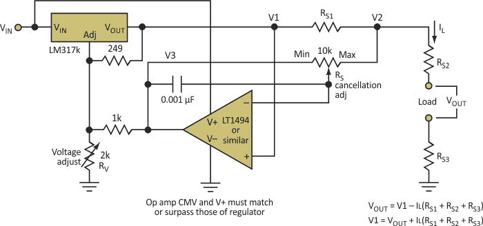

| Figure 1. | By developing a correction voltage using a separate current-sampling resistance, designers can eliminate the added circuitry of the four-wire Kelvin connection. |
The extra sense wires can be eliminated if the necessary VOUT correction voltage is developed from a separate current-sampling resistance: RS1 (Fig. 1). RS1 should have roughly the same resistance as the interconnection (wiring) resistances RS2 and RS3 (generally a few tens to hundreds of milliohms). In fact, it can be as simple as a meandering printed-circuit board trace. The op amp then sums a scaled version of the RS1 sampled voltage with the regulator output V1 to produce corrected feedback and net load power VOUT that is constant and independent of load current.

The necessary polarity of the compensatory feedback depends on the style of regulator being used. Regulators that maintain a constant voltage differential between output and adjust pins (for example, the LM317) require positive feedback. Regulators that use a ground-referred reference voltage (for example, the LM2941) need negative feedback (Fig. 2). But in both cases, the feedback scale factor is adjusted using the same two-step procedure:
- With no load applied (IL = 0), adjust RV for the desired VOUT.
- Apply full load (IL = max) and adjust RS to restore the target VOUT.
