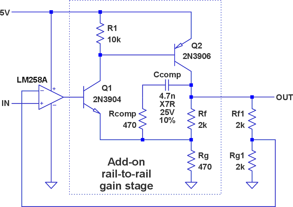

The LM358 family of dual op amps is among those hoary industry work-horse devices that are inexpensive and still have their uses. These parts’ outputs can approach (and for the inputs even include) their negative supply rail voltage. Unfortunately, this is not the case for the positive supply rail. However, cascading the op amp with a few simple, inexpensive components can surmount this limitation of the outputs (Figure 1).
This simple rail-to-rail gain stage, consisting of Q1, Q2, R1, RF, RG, RCOMP, and CCOMP, is driven by the output of the LM258A op-amp. Feedback network RF1 and RG1 help to ensure that the inverting input feedback voltage is within the op-amp's common-mode input range and to set a stable loop gain characteristic.
Figure 1. This simple rail-to-rail gain stage, consisting of Q1, Q2, R1, RF, RG, RCOMP, and CCOMP,
ensure that the inverting input feedback voltage is within the op-amp’s common-mode

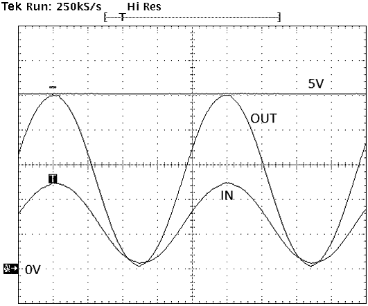

Here, rail-to-rail swings of the circuit's output are apparent.
Figure 2. Here, rail-to-rail swings of the circuit’s output are apparent.

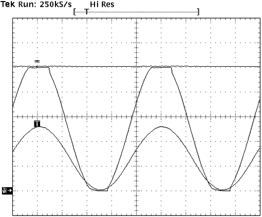

The circuit recovers from clipping gracefully.
Figure 3. The circuit recovers from clipping gracefully.граничения.

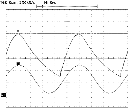

With a 0.1 µF load, slewing problems arise.
Figure 4. With a 0.1 µF load, slewing problems arise.

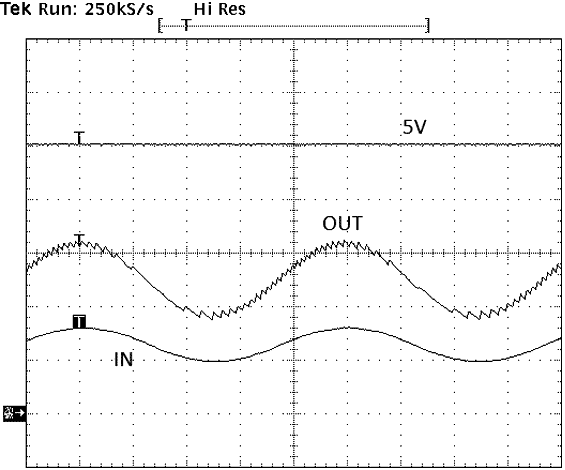

При подключении нагрузка 470 Ом параллельно конденсатору 0.1 мкФ схема устойчива и не демонстрирует проблем со скоростью нарастания.
Figure 5. A 470-ohm load in parallel with 0.1 µF is stable and
doesn’t exhibit slewing problems.

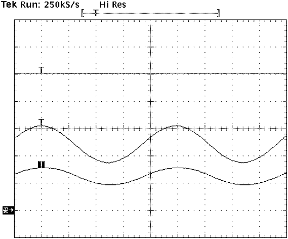

But with 0.1 µF as the sole load, the circuit is not stable.
Figure 6. But with 0.1 µF as the sole load, the circuit is not stable.
