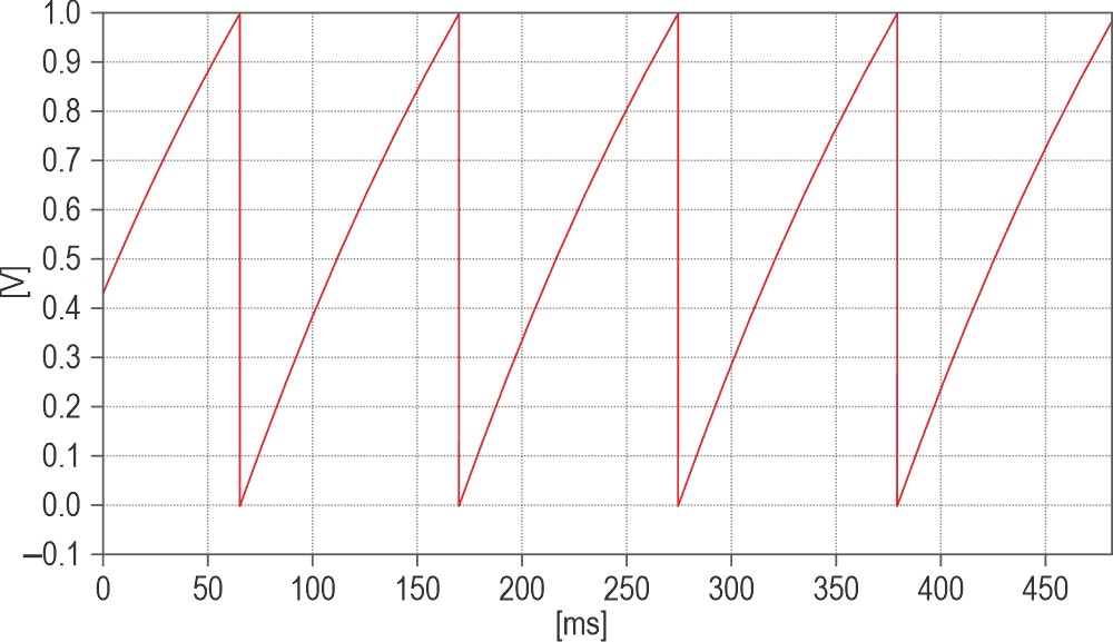

10 Hz sawtooth for an R6 of 12 MΩ.
Figure 2. 10 Hz sawtooth for an R6 of 12 MΩ.

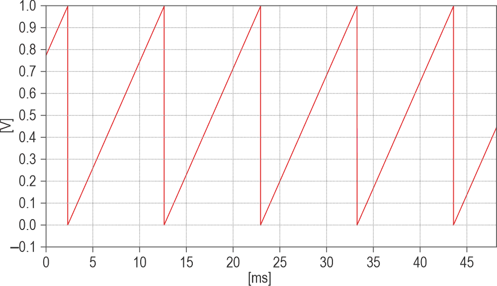

Figures 3 and 4 show near-ideal sawtooth waveforms. But Figure 2, with its 12 MΩ R6, shows that even when “off,” M1 has a non-infinite drain-source resistance which contributes to the non-linearity of the ramp. It’s also worth noting that although U3’s FB pin typically pulls less than 100 nA, that’s the current that the 12 MΩ R6 is intended to source, so waveform frequency accuracy for this value of resistor is problematic.

1 kHz sawtooth for an R6 of 120 kΩ.
Figure 4. 1 kHz sawtooth for an R6 of 120 kΩ.

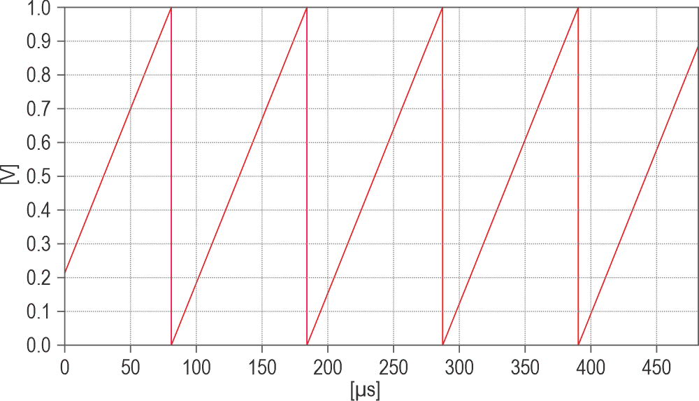

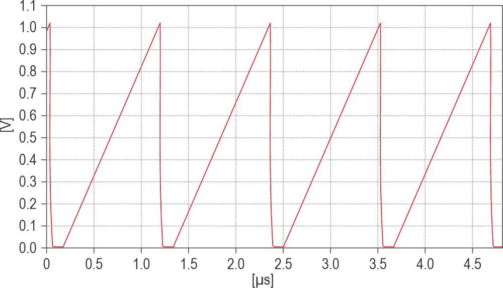

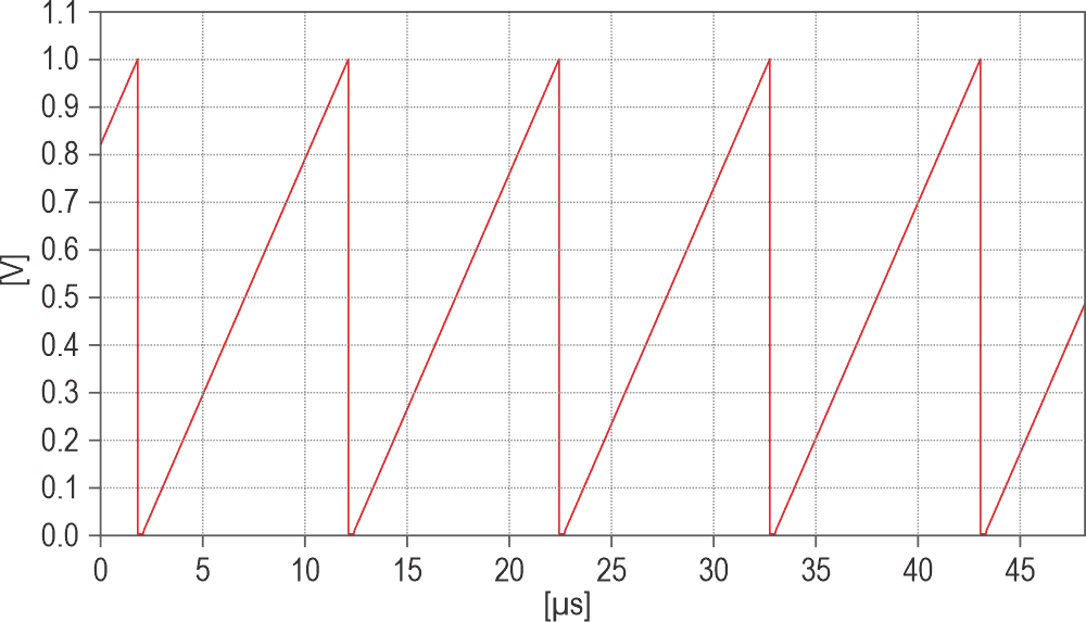

Figures 5, 6, and 7 show progressive increases in the effects of the 100 ns discharge time for C3 and of the finite recovery time of the op amp when its output saturates near the ground rail.
10 kHz sawtooth for an R6 of 12 kΩ.
Figure 5. 10 kHz sawtooth for an R6 of 12 kΩ.
100 kHz sawtooth for an R6 of 1.2 kΩ.
Figure 6. 100 kHz sawtooth for an R6 of 1.2 kΩ.
