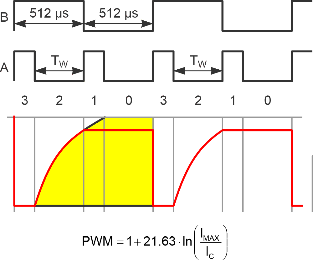

Antilog conversion occurs in a four step ~1 ms cycle defined by the combined states of the GPIO PWM bit and D flip/flop decoded by the 4052 analog switch as shown in Figure 2.
TW = antilog RTCT timeout = 1 to 250 counts = 2 to 500 µs, where PWM - see figure.
Figure 2. TW = antilog RTCT timeout = 1 to 250 counts = 2 to 500 µs,
where PWM – see figure.
The antilog conversion sequence is as follows:
  • BA = 3: duration 12 µs. Timing capacitor CT charged to VDD – 1.24 V.
  • BA = 2: duration TW = 2 µs to 500 µs. CT exponentially discharged toward VDD with time-constant RTCT = 43.4 µs.
  • BA = 1: duration 0 to 498 µs. CT residual charge transferred to CSH sample and hold cap.
  • BA = 0: duration 2 µs to 500 µs. CT residual charge continues to transfer to CSH.
At the end of each 4-step, 1024-µs cycle, CSH will converge toward a charge relative to VDD between 12 µV and 1.2 V, determined by the antilog of the 2 µs to 500 µs duration of phase 2 of the conversion sequence. The 1-µV typical input offset of the LT2066 makes this adequate for (reasonably) accurate digital to analog conversion. Convergence of VCsh to 8-bit precision takes a maximum of 8 cycles = 8.2 ms.

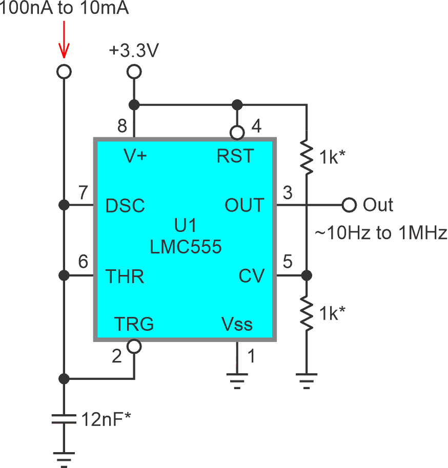

Final conversion of the resulting 5-decade current source to a 5-decade frequency output (the point of the exercise) can be done simply (if admittedly kind of crudely) with the circuit in Figure 3.
A minimal 5-decade sawtooth oscillator that enables final conversion of the resulting 5-decade current source to a 5-decade frequency output.

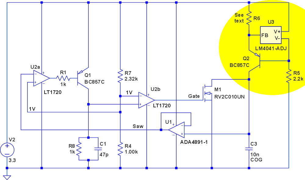

Or it can be done much more precisely with Christopher Paul’s DI by substituting Figure 1 for his original resistor-programmed current source (highlighted in yellow), as shown in Figure 4.
Maximal 5-decade sawtooth oscillator, using Christopher Paul's DI (Ref. 1).

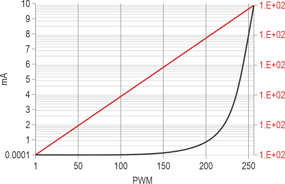

The plot of source current versus PWM are shown in Figure 5.
Log (red) and linear (black) plot of source current versus PWM.
