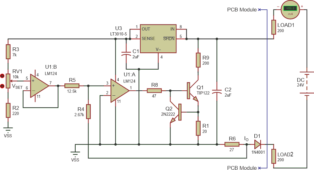

Figure 1 describes a circuit where the variation of loop current is linear. Here, the loop current is directly proportional to the voltage set by potentiometer RV1. Moreover, this current can service a source or sink load up to 500 ohms without need for recalibration. These two requirements are essential for a loop current generator in process industries.
With this linearly adjustable two-wire current source, RV1 is adjusted to set the current, and either LOAD1 (source) or LOAD2 (sink) can be connected.
Figure 1. With this linearly adjustable two-wire current source, RV1 is adjusted to set the current, and either LOAD1 (source)
How does the circuit work? First connect a 24 V DC supply, a DC ammeter and a load resistor – say, 200 ohms – at the source or sink side. In field applications, this portion is built into the I/P converter, DCS or PLC.

Other comments, in closing:
  • U3 generates 5 V DC.
  • Q1 and U1A adjust the loop current IO proportional to VSET.
  • R1 and Q2 set the current limit for IO at approximately 30 mA for safety reasons.
  • The loop current is settable from 0.5 mA to 23.5 mA, which is sufficient for this application.
  • For different current settings, select R3, R2 and R5 as per the equation given earlier for IO.
  • And Q1 requires a heat sink.
