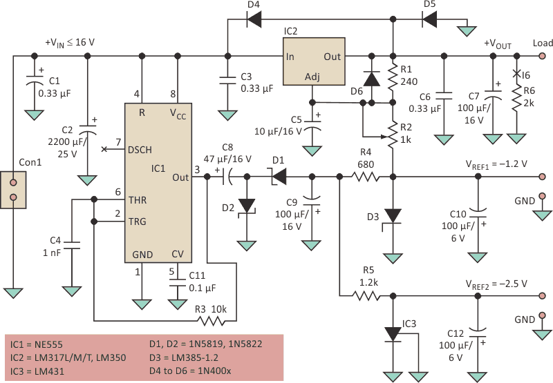

The second approach is useful where circuits operate from a single power supply, such as 6-V or 12-V rechargeable batteries, and the input power supply is usually limited to around 16 V (Fig. 2). In these cases, you reduce and offset the output voltage of the LM317x by offsetting the voltage-adjustment resistors.
For situations where the supply rail is positive and limited, a passive approach using resistors is an alternative to the active techniques from Figure 1.
Figure 2. For situations where the supply rail is positive and limited, a passive approach using resistors is an alternative
An NE555 and associated components can be used to produce a negative voltage. Here, it produces –1.2 V for the offset of LM317x and –2.5 V for the analog circuits in the system. The working frequency of the oscillator is usually set between 20 kHz and 200 kHz. D1 and D2 should be fast-switching diodes with low-voltage drop such as the 1N5819 or 1N5822. D3 is a voltage-reference or parallel voltage regulator providing the offset, such as the LM385-1.2 V. Resistor R6 is optional. It provides most of the minimal load current for IC1, if needed.

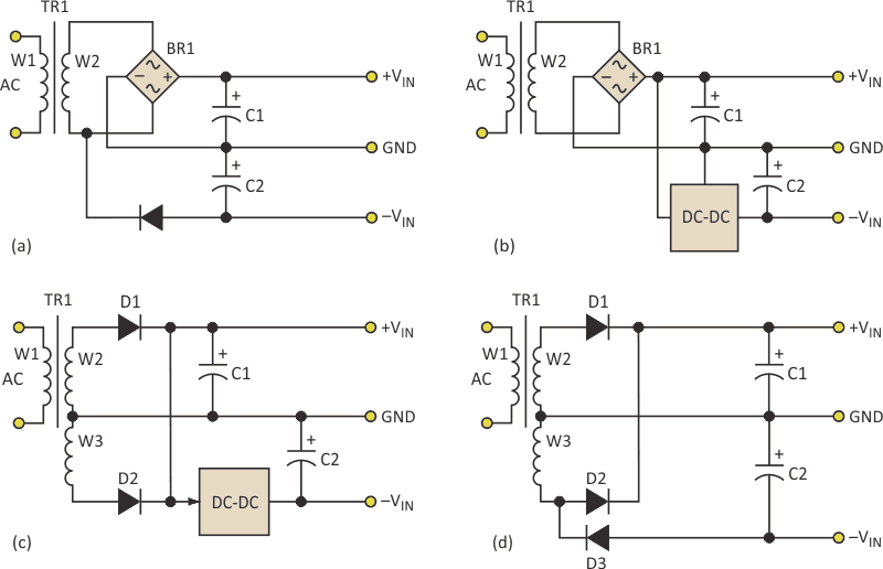

Figure 5. If a negative voltage is needed, there are various common techniques to generate negative dc rails from
an ac supply, including a full-wave bridge plus additional diode (a), a full-wave bridge plus negative dc-dc
converter and regulato (b), a half-bridge plus negative dc--dc converter and negative regulator (c), and
a half-bridge plus diode pick-off (d).
Figure 5 provides several ideas for generating the negative voltage needed to offset the ground or regulation/adjustment pins of the regulators, using the NE555 or other methods.
