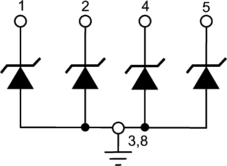

With reverse breakdown voltage (VBR) at 6.2 V typ., peak pulse current (IPP) per IEC61000-4-5 as much as 5 A, ability to withstand ESD strike (VESD) per IEC61000-4-2 up to ±12 kV for air and contact discharge, these devices meet or exceed all requirements for protecting the high-speed interface like USB Type-C™ from possible ESD hazards. The ultra-low channel input capacitance (CJ) at 0.45 pF ~ 0.5 pF typical enables good signal integrity for reliable data transfers over the high-speed interfaces.
