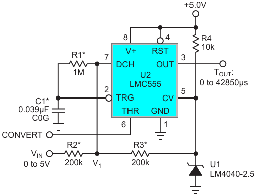

High resolution voltage-to-time ADC …
High resolution voltage-to-time ADC suitable for self-heated transistor anemometer linearization. An asterisk denotes precision components (1% tolerance)

15-bit voltage-to-time ADC for "Proper Function" anemometer linearization
Figure 2
Figure 1. The V
OUT
versus airspeed response of the thermal sensor is very nonlinear
Figure 2. High resolution voltage-to-time ADC suitable for self-heated transistor anemometer linearization. An asterisk denotes precision components (1% tolerance)
Figure 3. ADC cycle begins with a CONVERT THR pulse that generates an OUT pulse of duration T
OUT
= ln(V
1
/1.25 V)R1C1
